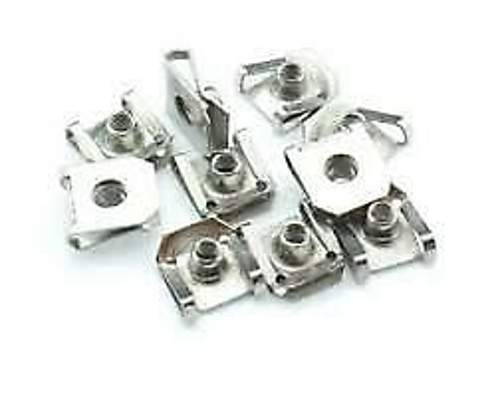

https://www.ebay.de/itm/142173886175?ul_noapp=true
