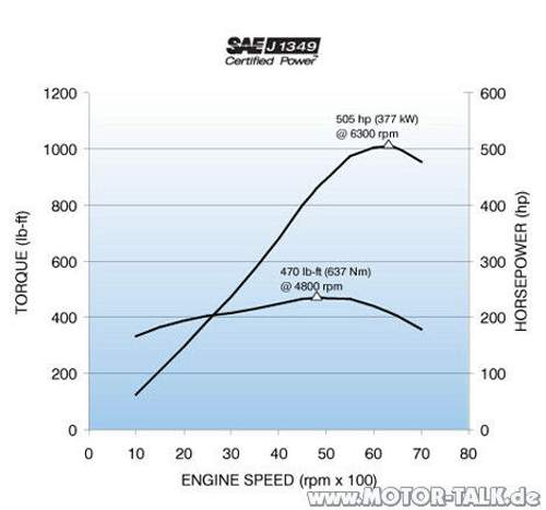

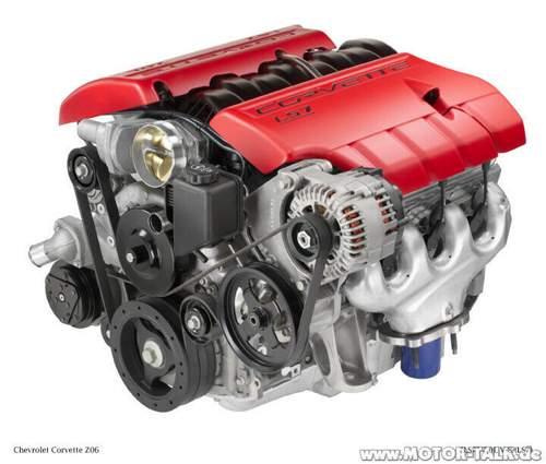

So, da ich keinen direkten Link zu der GM Powertrain Seite machen kann, hier die Zusammenfassung vom "aktuellen LS7"
Overview
The LS7 is easily identified under the hood by red engine covers with black lettering. It shares the basic architecture of other Gen IV V-8 engines, but is the largest-displacement variant, featuring pressed-in steel cylinder liners to accommodate the engine's larger diameter, 4.125-inch (104.8 mm) cylinder bores. It also uses a racing-style dry-sump oiling system that helps ensure adequate oil pressure during high-load cornering.
Each LS7 is assembled by hand by a single builder at GM's unique Performance Build Center in Wixom, Michigan. The 100,000-square-foot facility weaves the best practices of low-volume niche manufacturers and the established quality and manufacturing standards at GM to ensure the highest-quality specialized engines.
Cylinder Block
The LS7's Gen-IV cylinder block shares two key design elements with GM's original small-block V-8: a 90-degree cylinder angle and 4.400-inch bore centers. The LS7 uses unique pressed-in cast iron cylinder liners to accommodate the largest cylinders bores in the engine family. The LS7 block also features very durable, doweled-in, forged-steel main bearing caps, which hold the balanced, forged-steel crankshaft in place and reduce crank flex.
The Gen IV block was developed with math-based tools and data acquired in GM's racing programs, and provides a light, rigid foundation for an impressively smooth engine. Its deep-skirt design helps maximize strength and minimize vibration. The bulkheads accommodate six-bolt, cross-bolted main-bearing caps that limit crank flex and stiffen the engine's structure. A structural oil pan further stiffens the powertrain.
Deck Plate Honing
A precision machining process typically reserved for high-performance engines, is used on the LS7 cylinder block to maximize engine life, reduce friction between engine parts and increase horsepower. It is advantageous in applications where cylinder head pressures are greater than average – such as with a supercharged engine – to ensure cylinder sealing and prevent scuffing of the piston against the bore wall. In the LS7 engine, this means improved bore life and ring sealing. True bores and better sealing are keys to optimizing power.
Racing-Derived Cylinder Heads
The LS7's large displacement would mean little in terms of horsepower if the engine could not draw in and then expel enough air to take advantage. To that end the LS7 is fitted with high-flow cylinder heads that are derived from racing heads first proven on the track with the Corvette Racing team. The heads feature fully CNC-machined intake, exhaust ports and 70cc combustion chambers to reduce airflow restrictions, while the high machining consistency of the machining procedure enable's the LS7's high, 11.0:1 compression ratio.
High-Flow Intake Manifold with Acoustic Shell
The LS7's intake manifold ports are designed to match cylinder head. The composite manifold is manufactured with a lost core process to improve runner-to-runner variation and to reduce flow losses. Acoustic foam is sandwiched between the outside top of the intake manifold and an additional "skull cap" acoustic shell to reduce radiated engine noise.
Dry Sump Oiling System
Corvette models equipped with a manual transmission feature a dry sump oiling system which promotes exceptional lubrication system performance during extended high-rpm use under high cornering loads.
Advanced Electronic Throttle Control
With ETC, there is no mechanical link between the accelerator pedal and the throttle body. A sensor at the pedal measures pedal angle and sends a signal to the engine control module (ECM), which in turn directs an electric motor to open the throttle at the appropriate rate and angle. The ETC system can deliver outstanding throttle response and greater reliability than a mechanical connection
58X Ignition System
The LS7 has an advanced 58X crankshaft position encoder to ensure that ignition timing is accurate throughout its operating range. The new 58X crankshaft ring and sensor provide more immediate, accurate information on the crankshaft's position during rotation. This allows the engine control module to adjust ignition timing with greater precision, which optimizes performance and economy. Engine starting is also more consistent in all operating conditions.
Hydroformed Exhaust Manifolds
The exhaust manifolds are made of hydroformed stainless steel, which is lighter than cast iron, and feature a unique four-into-one collector that designed to maximize airflow. Exhaust pipes on the LS7-equipped Corvette Z06 are three-inches in diameter, compared to the 2.5-inch pipes on Corvettes built with the 6.0L LS2
Also wenn ich das so lese, dann ist der "neue" LT1 einfach nur en LS7 mit nem neuen Namen.
Oder hab ich da irgendwas übersehen?
