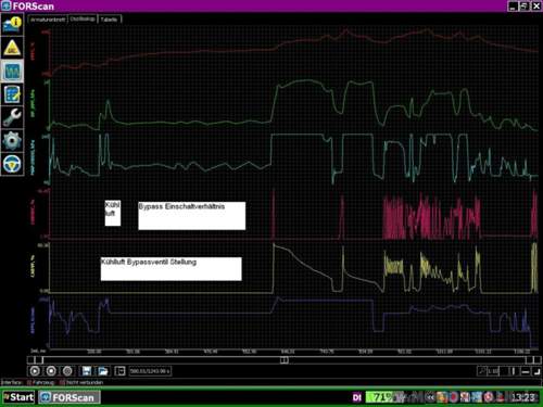

Themenstarteram 10. Februar 2014 um 14:43
bei meinem 1,6 TDCI liegt zwar kein OBD-Fehler an, aber er läuft nicht richtig. Alle Systeme werden als ok gemeldet!
Mit dem OBD-Link mx Adapter und der OBDLink Software habe ich einige Werte (nicht alle werden beim Diesel angezeigt)
Time, Vehicle speed (km/h), Fuel rate (l/hr), Engine coolant temperature (C), Fuel rail pressure (gauge) (kPa), Mass air flow rate (g/s), Fuel rail pressure (kPa), Commanded EGR (%), Control module voltage (V), Relative throttle position (%), Total fuel economy (l/100 km), Instant fuel economy (l/100 km), Engine RPM (RPM), Intake manifold absolute pressure (kPa), Calculated load value (%), Fuel rail pressure relative to manifold vacuum (kPa), EGR error (%), Commanded evaporative purge (%), Fuel level input (%), Number of warm-ups since DTCs cleared, Catalyst temperature (Bank 1 Sensor 1) (C), Catalyst temperature (Bank 2 Sensor 1) (C), Catalyst temperature (Bank 1 Sensor 2) (C), Catalyst temperature (Ban7k 2 Sensor 2) (C), Fuel/Air commanded equivalence ratio, Commanded throttle actuator control (%), Intake air temperature (C), Absolute throttle position (%), Oxygen sensor voltage (Bank 1 Sensor 1) (V), Short term fuel trim (Bank 1 Sensor 1) (%), Oxygen sensor voltage (Bank 1 Sensor 2) (V), Short term fuel trim (Bank 1 Sensor 2) (%), Oxygen sensor voltage (Bank 1 Sensor 3) (V), Oxygen sensor 1 lambda, Oxygen sensor 1 voltage wide range (V), Oxygen sensor 2 lambda, Oxygen sensor 2 voltage wide range (V), Barometric pressure (kPa), Oxygen sensor 1 lambda wide range (current probe), Oxygen sensor 1 current wide range (mA), Absolute load value (%), Ambient air temperature (C), Absolute throttle position B (%), Absolute throttle position C (%), Accelerator pedal position D (%), Accelerator pedal position E (%), Accelerator pedal position F (%), Fuel rail pressure (absolute) (kPa), Relative accelerator pedal position (%), Engine oil temperature (C), Fuel injection timing (deg), Engine fuel rate (l/hr), Short term fuel % trim - Bank 1 (%), Long term fuel % trim - Bank 1 (%), Short term fuel % trim - Bank 2 (%), Long term fuel % trim - Bank 2 (%), Longitude, Latitude, Altitude (m), Bearing (deg), GPS Speed (m/s), GPS Accuracy (m)
mitgelogt (siehe csv.Datei)
Was mich wundert, ist dass der Raildruck so stark schwankt (so zwischen 20 000 und 100 000 kPa) was wohl so etwa 200 bis 1000 bar sind.
Frage an die Experten: Ist das normal?

Hallo carli80,
Als erstes ist der DPF voll und muss gereinigt werden. Werte über 20 kPa Differenzdruck habe ich noch nie gehabt.
In Bild 1 ist eine aktuelle Regeneration von Heute auf der Autobahn mit ca 120 km/h. Der Differenzdruck liegt bei ca 5 kPa.
Der Raildruck (FRP) von 200 bis 1000 Bar ist in Ordnung. Bei mir in den Bildern von 20 bis 100 MPa. MPa x 10 = Bar.
Die Bypassklappen werden nur bei einer Regeneration betätigt. Das heißt, dein Motor will andauernd regenerieren. Durch den zugesetzten DPF ist die Lufttemperatur zu hoch und der Luftdurchsatz zu gering. Sowie der Turbodruck zu hoch. Die Lufttemperatur sollte beim regenerieren ca 50 Grad und sonst Außentemperatur haben.
Wegen dem zu hohen Druck und der zu hohen Temperatur ist bei dir das Rohr geplatzt.
Also DPF ausbauen und spülen mit Hochdruckreiniger und Wasserschlauch, bis klares Wasser kommt. Dann alle Öffnungen abdichten und ein Liter Grillreiniger mit kochendem Wasser einfüllen. Das Ganze über Nacht stehen lassen und am nächsten Tag nochmals Spülen, bis klares Wasser kommt. Dann mindestens 2 Sunden stehen lassen und mehrmals das Wasser auskippen. Nach dem Einbau den Motor einige Zeit im Leerlauf laufen lassen und dann min 10 km mit niedrigen Drehzahlen fahren damit das letzte Wasser langsam entwicht.
Danach muss der Zähler für den DPF im Steuergerät zurückgesetzt werden.
Zum reduzieren des Rußes und zum reinigen der Einspritzdüsen einen halben Liter 2Tacktöl Teilsynthetisch auf den vollen Tank kippen. Am besten von LM.
Ich fahre seit über 60 tkm mit 2TÖl im Verhältnis 1:200.
Ich glaube nicht, das die Bypassklappen defekt sind, aber weitere Fehler kann man erst nach gereinigtem DPF sehen.
Gruß Karlo49

hat besser gewirkt als gedacht. Die BC Verbrauchsanzeige war natürlich schrecklich - so 10 bis 12 l/100 km.
Aber offensichtlich hat es gefunzt.
Wenn ich die Daten richtig interpretiere, dann sieht es so aus, als wäre auch der Raildruck bereits bald gleichmäßger gewesen.
In der abschließenden Abkühlphase mit Tempo 90 bis 120 ist auch nach der Intake Air Temperatur zu erkennen, dass kein Regenerationsversuch durchgefuhrt wird.
Fazit: Dein Tipp vielleicht auch in Verbindung mit dem Liqui Moly hat gute Ergebnisse gebracht
