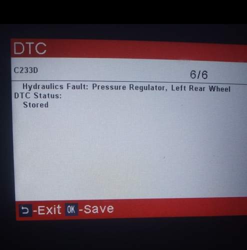

I have same problem but worse. My 2002 w211 E500 keeps pumping every 10 seconds while parked. The red stop car, brake defect ...etc are on and the brakes fails randomly rendering car not drivable.
I have the following codes.... Advice needed. Do I need a new SBC module or just the accumulator pump?

New SBC unit. Or drive it until a tree jumps right in front of you to stop you from 200 km/h to 0 km/h at about 50 cm braking distance. It’s a guaranteed rush like in a roller coaster - death is almost certainly included free of charge. :D
