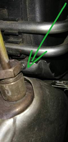

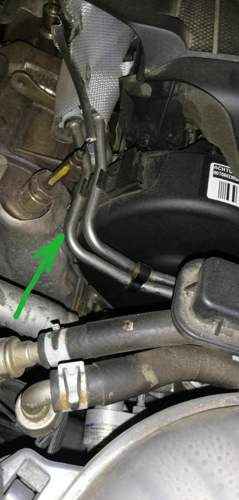

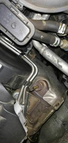

sounds like a thin piece of metal vibrating. is it more on the gearbox side below battery? between engine and gearbox is such a piece which can sometimes vibrate.
what does the mechanic say if you show him your video? should be easier for him to have a look

Had a similar sound, seemed to be a pump, VW knows about this phenomenon, their TPI recommends to do nothing
Themenstarteram 17. Dezember 2019 um 19:33
Hi mgierse, what kind of pump?
Themenstarteram 17. Dezember 2019 um 19:53
Did you replace the pump? Was it expensieve? Please let me know
No I didn’t, according to VW this is a „normal“ sound, VW‘ recommendation for their shops: leave it just the way it is
