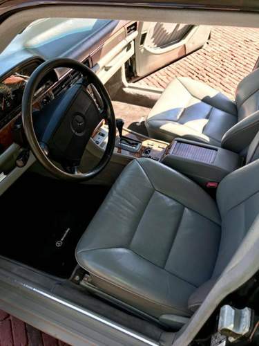

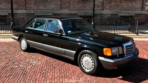

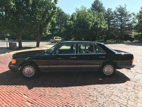

Zu verkaufen für 4250 $. Was wäre der hier bei uns wert, unterstellt, dass alle Behauptungen im Inserat der Wahrheit entsprechen?

Zur Vollständigkeit der Text aus dem Inserat:
Last year for the 560SEL. It has ABS, driver & passenger airbags. Everything works! All the windows, locks, cruise, heat, AC, rear reclining seats, 4 seat heaters, telescoping steering wheel.
I have replaced numerous parts over the past year:
10/16 - Bridgestone Insignia Tires
1/17 - Fuel Injection Electro Hydraulic Actuator ~$500
1/17 - Idle Control Unit and Idle Control Valve ~$500
1/17 - K&N air filter
1/17 - Full Tune up (plugs (OE copper core), wires, distributor cap and rotor)
2/17 - NEW AC compressor and drier ~$1000
2/17 - Cold start injector
3/17 - Outside temperature gauge & sender unit
3/17 - Coolant temperature sensor & sender
5/17 - Seat belt warning relay module
Exterior paint - 6/10 (minor hail and scratches on the hood)
Interior - 8/10
Mechanical - 8/10
560-1
560-2
560-3
