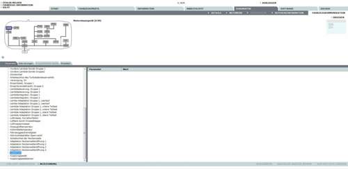

So
Vida sagt :
ECM 6805 TC Control System boost pressrure fault - pressure too high
Der Fehler ist mit GELB hinterlegt
Eventuell sollte ich erwähnen, dass ich diesen Fehler nicht das erste Mal am Vida habe.

Vida sagt :
Hast du Vida? Falls nicht, steht dann weiter dazu:
284: ECM-6805 Turbocharger (TC) control valve. Pressure too high. Permanent/Intermittent fault, B5204T5
Diagnostic trouble code (DTC) information
Condition
If engine speed (RPM) is above 3500 rpm and the engine is operating at a high load, and if the boost pressure (from the boost pressure sensor) is higher than a designated value, which at maximum boost pressure is approximately 20 kPa (2.90 psi) above normal boost pressure, this is interpreted as a fault and diagnostic trouble code (DTC) ECM-6805 is stored.
Substitute value
reduced boost pressure
Possible source
hoses between turbocharger (TC) and turbocharger (TC) control valve respectively turbocharger (TC) control valve and pressure servo are loose or are blocked/damaged
faulty turbocharger (TC) control valve
faulty boost pressure control (BPC) valve pressure servo
sticking boost pressure control (BPC) valve
