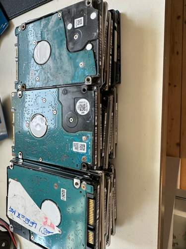

Moin, bei meinem F11 wird das USB nicht mehr gelesen und das Navi bootet nicht. Es bleibt beim „Navi wird gestartet“
Kann mir jemand aus NRW helfen neu zu Flashen? Evtl neue SSD ? Und wie kommen wir hier in Kontakt ?

No, that's not strange. They did the AC disinfection with a spray into the middle air jets. When they use it too long the spray becomes liquid again and flows downwards. What is unter the air channel? Yepp, the Head-Unit and on top of the Head-Unit is the DVD and right below the HDD. The HDD does not like the desinfactant liquid really much.
CU Oliver

Wäre alleine bei mir und in diesem Jahr das 20. NBT mit diesem Fehler nach Desinfektion. Das killt die Festplatte sehr zuverlässig. Da darf eine neue rein, natürlich passend fertig gemacht vorher.
CU Oliver

Hallo!
Am einfachsten ist
NBT ausbauen und mir zusenden
Ich baue eine neue HDD ein, passe die an und spiele die Navi Daten wieder rauf
CU Oliver

Hello!
First at all you have to buy a correct one. A NBT is very special in case of new HDD cause it will accept only HDDS with the correct S.M.A.R.T. attributes. You cannot clone the HDD cause the old one is broken. But also when it won't be broken, a NBT HDD is locked and not readable.
So you have to insert the right one and you have to have an open SSH port for the NBT to format it and to create the correct directories on it. Therefore you should have the correct commands - they are different from the evo schemata cause a NBT comes not from the Omap side to do it. Or you are using a special image to make your life easier and to do it faster. But those images are not for sale cause you cannot protect it. So it's much easier to send the unit to a friend or company who will do it for you. Normally it will cost something around 150€ including the newest map (atm Next West 2-2023) on the HDD.
CU Oliver
