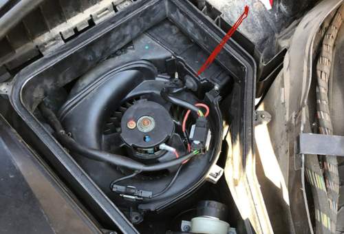

Hello :)
Sorry for the English, I don't speak German (yet)
I have 1992 300se (m104.990) without aircon
vin: wdb1400321a013546
I struggle to find hvac blower resistor, because, well, the blower doesn't look like anything I found on the internet.
All pictures that I've seen show the resistor placed directly on top of the blower, but it's not what I see.
Is anyone familiar with this type of blower?
I've attached a couple of pictures, and the sticker that was on the blower housing
P.s> google doesn't know anything about the number that is covered by the black wire on my photos
Blower housing part number
Hvac blower view
Blower view

the answer is quite simple:
Your car was built w/o A/C - therefore the blower regulator is not fitted.
To confirm that this is the case I had a look at the EPC for your VIN.
As you can see in the screenshot the blower regulator is greyed out, meaning that the part is NOT fitted.

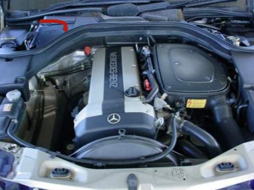

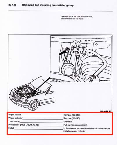

As I suspected your heater/ventilation only car does not use electronic speed regulation.
Image #1 shows the resistor A32r1,2,3 group on the wiring diagram, part# 140 820 05 97 (refer image 2).
Check out image #7 for the location.
Mercedes-Benz have a habit of mounting such parts in an air duct to provide cooling.
If you unplug the connector you should be able to test the voltages coming from the pushbutton unit and if they look normal then the fault would be in the resistor group.

I would strongly recommend you proceed according to the KIS method - keep it simple.
Unplug the resistor group plug, check the incoming voltage to the resistors and then decide whether they need repair, replacement ? Check the resistor value of each pre-resistor 0.15, 0.45 and 1.2 Ohm.
I would not do any trial-and-error purchase of an electronic regulator and then send it back because it's not suitable for your car.
Good luck

da ist kein Regler verbaut, schau mal die Bilder vom TE vom Lüftermotor an dann siehst du es. Was nicht eingebaut ist kannste auch nicht ausbauen.
