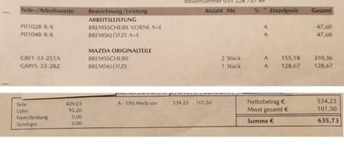

Will also need to replace the front brakes, discs show signs of warping. Never had to change brakes at such a low mileage before (once ran a mk7 Golf for 123k miles / just shy of 200Mm without replacing any pads or discs).
