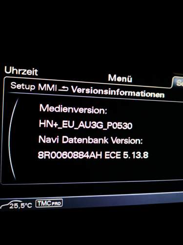

Hi gentlemen,
Attached is the version I have on my B8.5.
Do I need to do a software update in order to do a map update?
What is the latest software version and where is the changelog to see the improvements/changes?
Do you find it really necessary to do the software update to the latest version?

@Forf schrieb am 27. November 2019 um 00:59:52 Uhr:
No.

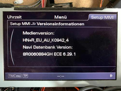

you need the newest firmware, before you can update the newest MAP-Update, for youre Navigation is:
Firmware:HN+_EU_AU3G_K0942
Newest Map-Update is: 6.29.1
simply wrong!
No FW-Update necessary, if K0900 is resident.

das ist die aktuelle FW dazu die aktuelle map..
